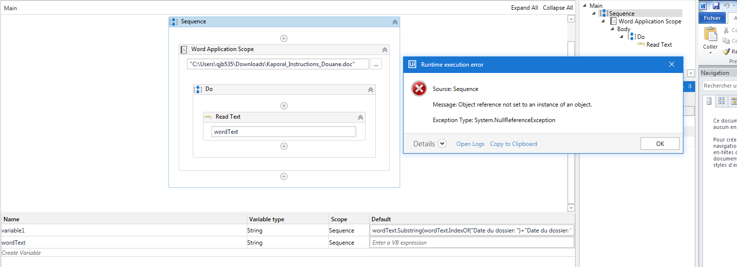

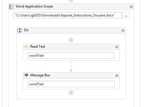

No the document is not empty.
I can read the file, and use a message box to display all the text.
But when i try something like that ( wordText.Substring(wordText.IndexOf("Nb de colis: ")+"Nb de colis: ".Length).Split(Environment.NewLine.ToCharArray)(0) ) to retrieve a field in the file i get an error " object reference not set to an instance of an object "
I only got two variable
wordText ( retrieve the text of the document )
and subText a variable where i try string manipulation to retrieve only a field ( wordText.Substring(wordText.IndexOf("Nb: ")+"Nb: ".Length).Split(Environment.NewLine.ToCharArray)(0) )
this is the issue as we have nt obtained the value for wordText variable it is initialized in the variable panel right…
so remove that default value for variable1 in the variable panel and use a assign activity next to this SCOPE and assign there with that variable name and this expression

Thanks @Palaniyappan it’s work.
Now it’s just that the string manipulation isn’t that great to retrieve the exact value needed
