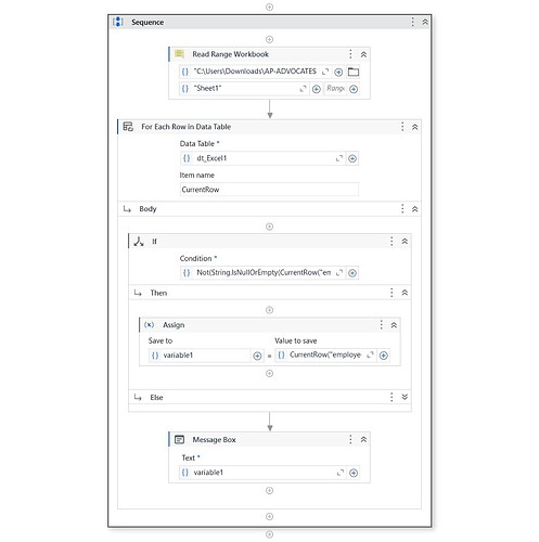

Hi @Krishnakumar_Vasudevan
→ If you are iterating the rows in a datatable by using For each activity. Output of for each is Currentrow.
→ Create a variable called Variable1.
→ Then use the If condition to check the condition as below,
Not(String.isnullorempty(Currentrow("employee id").toString))
→ Inside Then block insert the Assign activity and give as below,
- Assign -> Variable1 = Currentrow("employee id").toString
→ Then use the Variable1 if next row is empty it will store the previous value.
Check the below workflow for better understanding,
Hope it helps!!

Yes I already gave you the solution in the above reply… @Krishnakumar_Vasudevan
Follow the below steps,
→ Create a variable to store the Emp id called “Empid”
→ Use the For each activity to iterate the each row in the datatable.
→ Inside for each insert the If activity to give below condition,
→ Inside then block insert the assign activity and give expression as below,
- Assign -> empid = Currentrow("employee id").toString
→ Use the empid variable in the outside of If activity.
If 4th row is empty then it empid variable will store the 3rd row value.
Hope it helps!!
