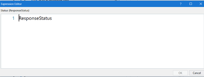

This activity has one output parameter that defines which of type ‘ResponseStatus’ which is of type ‘UiPath.BAF.Models.ResponseStatus’ and has got three properties
  1. Success(Boolean)
  2. ErrorCode(String)
  3. Message(String)
Drag a message box to the workflow to see the response status
Run the program and see the action
This would be the output
