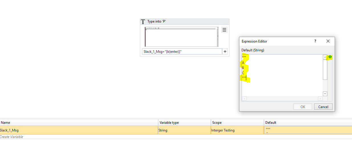

After realizing that, despite how easy and dummy-proof UiPath could be, you still require some understanding of programming language. So decided to purchase a textbook on Python and started studying. So far so good.
Here in my dumb (newbie) question.
In Python,
a = “”"
… A
… B
… C
When you print:-
A
B
C
This happens.
How do I achieve this UiPath?
Aw… the life of a newbie.
Add environment.newline between your chars.
Sidenote - a. Net language will be easier to transfer knowledge from to Uipath. I’d recommend either vb.net or c#. While Python is a great language it has enough differences from net that you might struggle a bit.
Strtemp = “a”+ Environment.Newline+ “b”+ Environment.Newline+“c”
