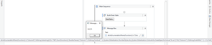

Hi @vishal.kp ,
Second expression worked but comma is important it gives this value: 93375
Expected: 933,75

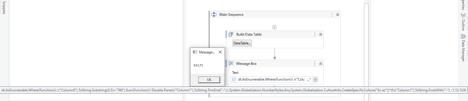

How about the following?
This returns Europian style numeric string.
dt.AsEnumerable.Where(Function(r) r("Column0").ToString.Substring(0,3)="760").Sum(Function(r) Double.Parse(r("Column1").ToString.TrimEnd("-"c),System.Globalization.NumberStyles.Any,System.Globalization.CultureInfo.CreateSpecificCulture("Es-es"))*if(r("Column1").ToString.EndsWith("-"),-1,1)).ToString(System.Globalization.CultureInfo.CreateSpecificCulture("ES-es"))
OR
This returns Double type
Sample20230503-3aLv2.zip (2.9 KB)
Double type is worked! Thanks
