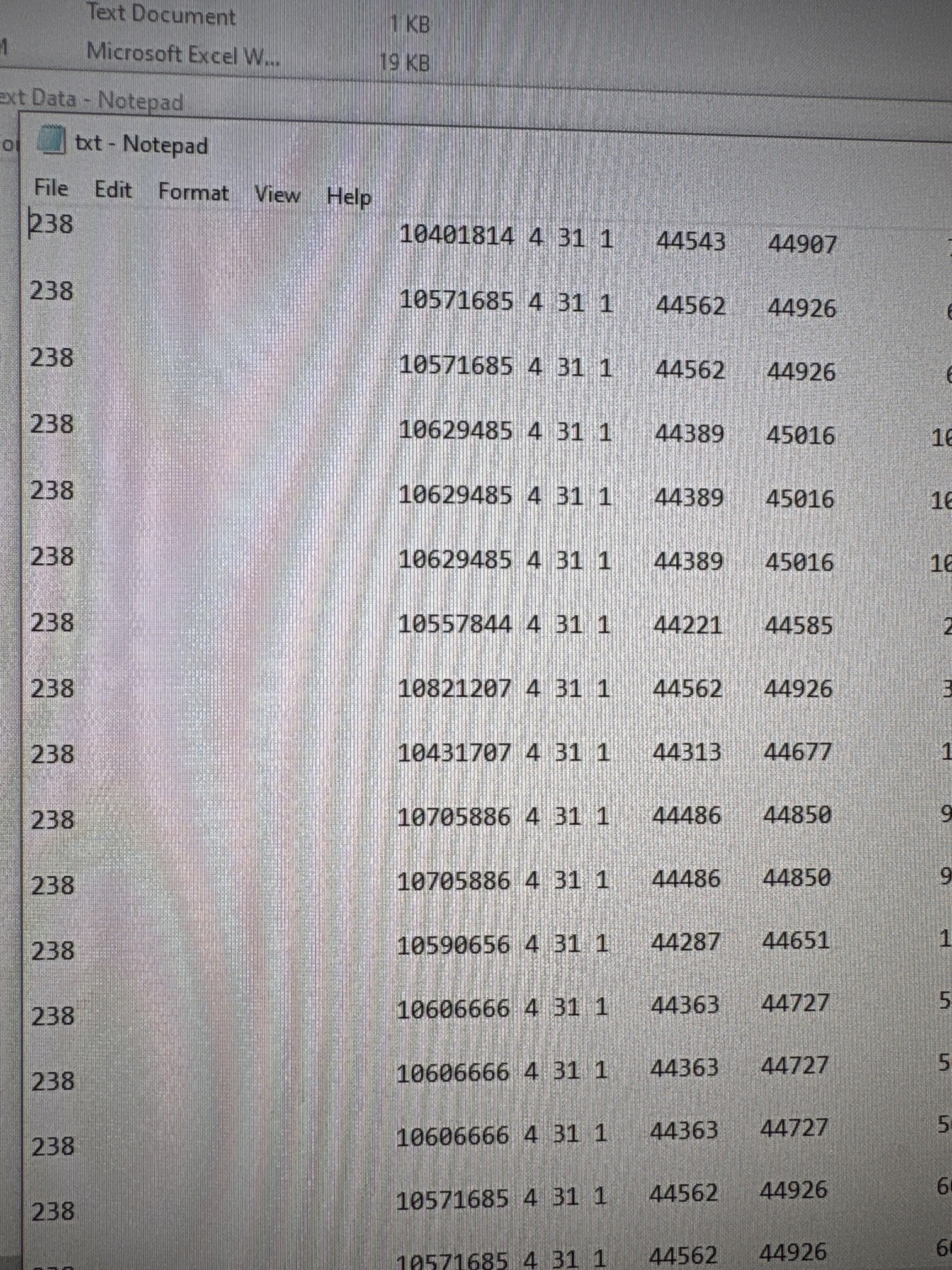

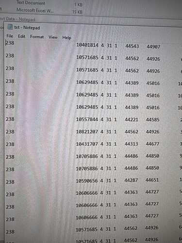

Hi, thanks for the solution but I have one issue
Please find the below image, the date should type as same as in the input file example if the date is 13122021 it should also type the same in the txt file as attached below.
strong text
But it is printing like this
strong text

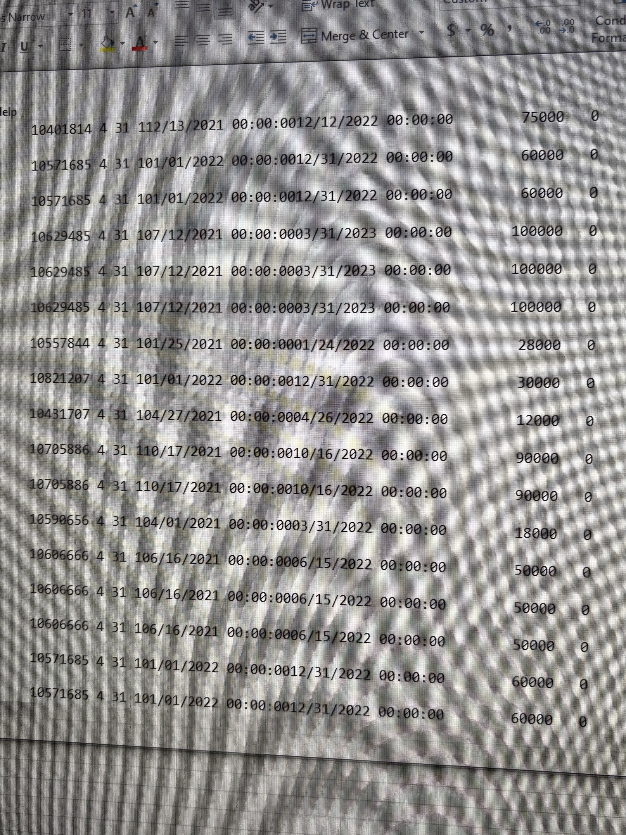

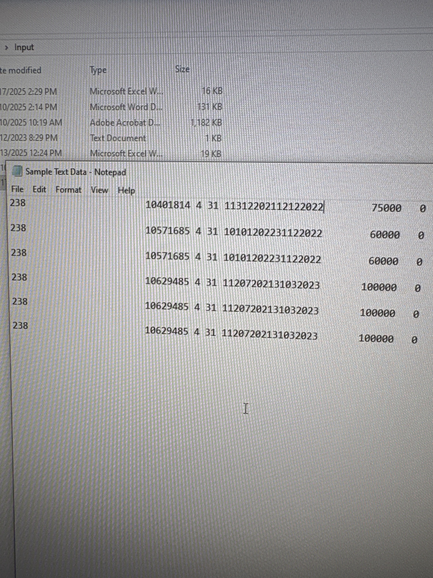

**it is coming like this, it threw an error **

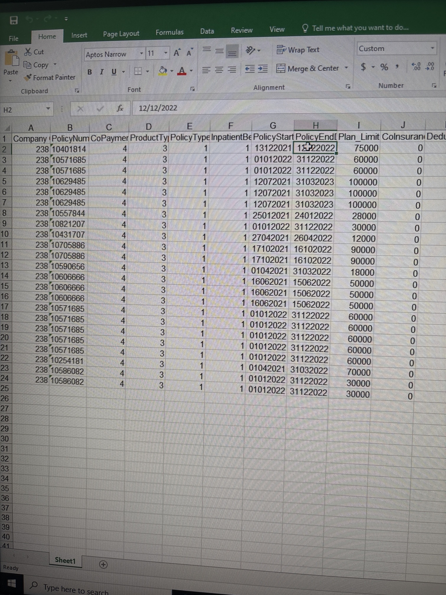

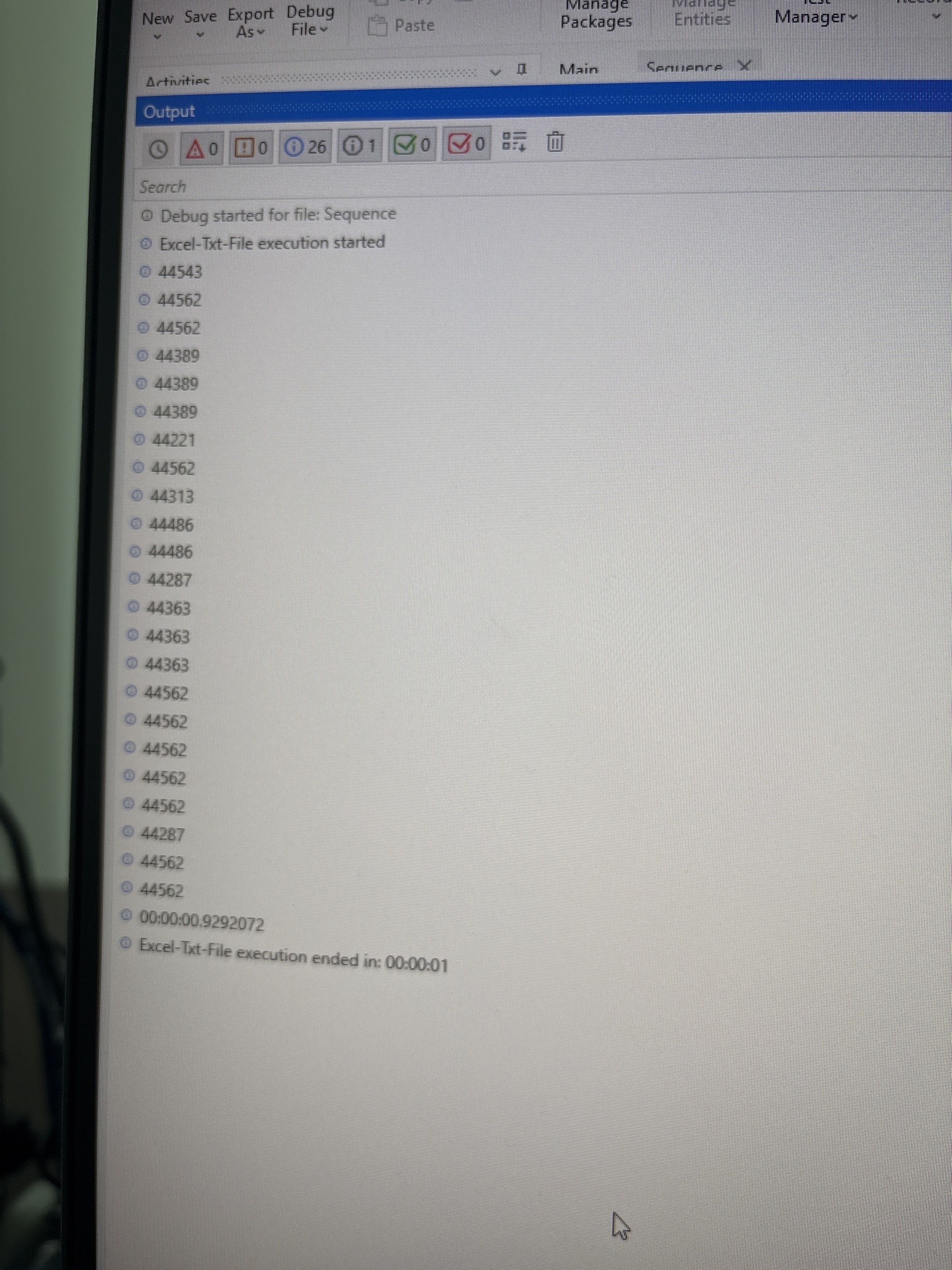

Could you check CurrentRow(7) in the immediate panel and tell me what it shows
**[quote="V_Roboto_V, post:13, topic:2752037, full:true this one?
This is row(6)

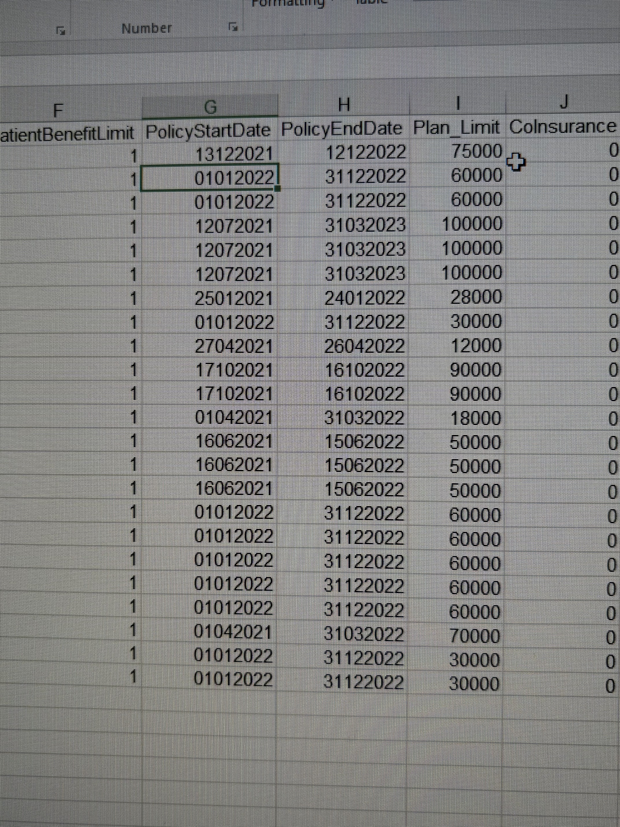

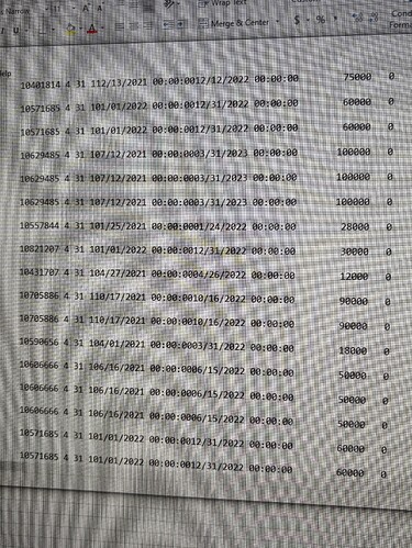

It should print like this…

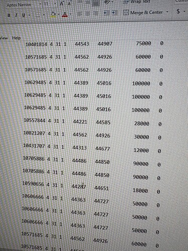

But it is printing like below
strong text

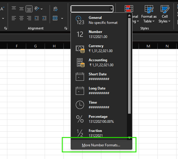

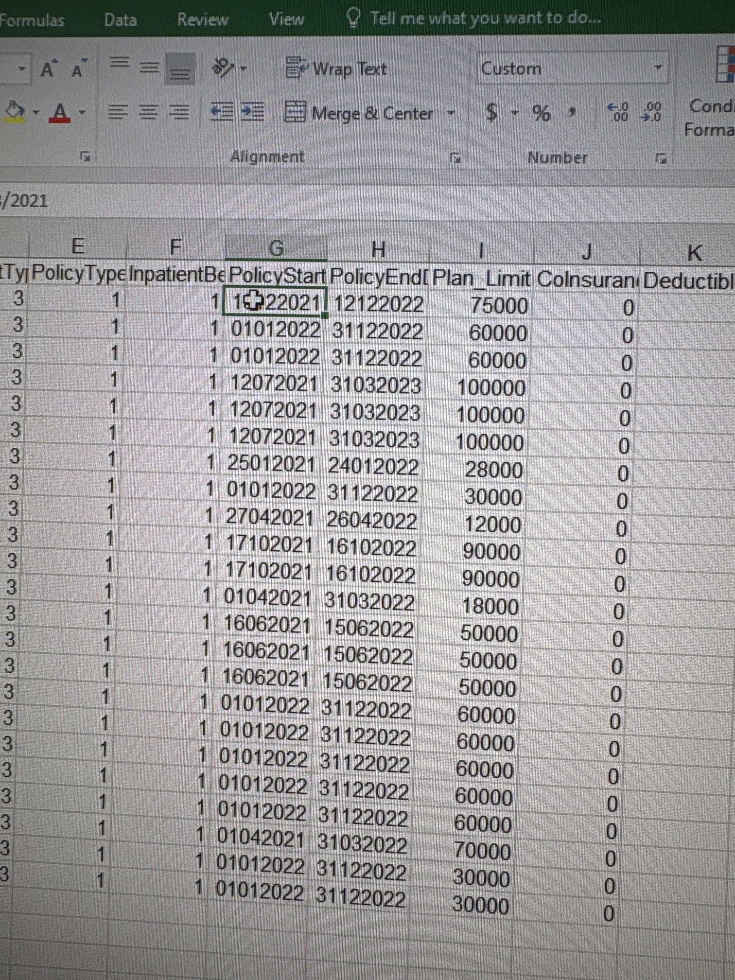

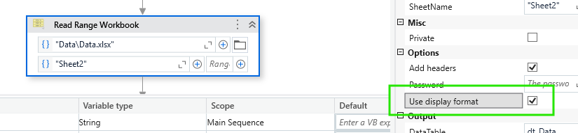

It is because of the data type that you have set for that column on Excel. I can see “Custom”.
Could you show the data format on excel?
The data is being read wrongly.
Also, Try with Use display format enabled and then try with ordinary assign of CurrentRow(6).ToString
It’s working fine now, I used the below logic DateTime.FromOADate(CDbl(row(6))).ToString(“ddMMyyyy”) Thanks for your help☺️
