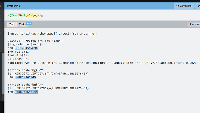

Output= System.Text.RegularExpressions.Regex.Match(Input,"(?<=20\:)[A-Z]*\d*").Value
Regards
Hi @Putta_Sri_Sai_Rishik_Chow
System.Text.RegularExpressions.Regex.Match(yourInputString, "(?<=:20:)[^\r\n]+").Value
You can use the below regular expression to get the value after :20:
System.Text.RegularExpressions.Regex.Match(yourInputString, "(?<=:20:).*").Value
The above expression will take after the values of :20:
Hope it helps!!

Sometimes we are getting the scenarios with combination of symbols like “-”, “.” ,“/” (attached text below)
thriesh oouhunbgbPAY
{1:,KJHJDGFXCVIUTG8765R}{2:POIFUHCVBN9087546R}
:20:UYHHG-865445
:20:UYHHG/8654.45
Thanks
mkankatala
(Mahesh Kankatala)
7
@Putta_Sri_Sai_Rishik_Chow you can try this
Try the above regex. This will work all the above scenarios
Output= System.Text.RegularExpressions.Regex.Match(Input,"(?<=20\:)[A-Z].*\d*").Value
System.Text.RegularExpressions.Regex.Match(str,“(?<=20:).*”).Value
