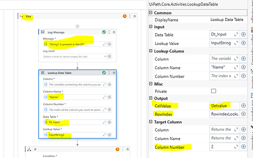

Hi @jamuna_T
You can try this way
  1. Assign the input string and read the excel file
  1. Then use the lookup data table activity
Here Mention the lookup column name ,Create the output of RowIndex , pass the Dt and Lookup value
  1. Use the If condition RowindexLookup.Equals(-1) if the string is not present in the Dt it will go to Then part. If its present it will go to Else part
  1. In Else part again use the lookup data table activity
    Mention all required fields and create the output of cellvalue and Mention the Target column 2 means it is Amount column value it will give
Note: cellvalue output variable type is System.object
  1. Again use the same if condition above mention as , if the string2 is present it will go else or else it will go to true.
Else part you can get the Amount column value
