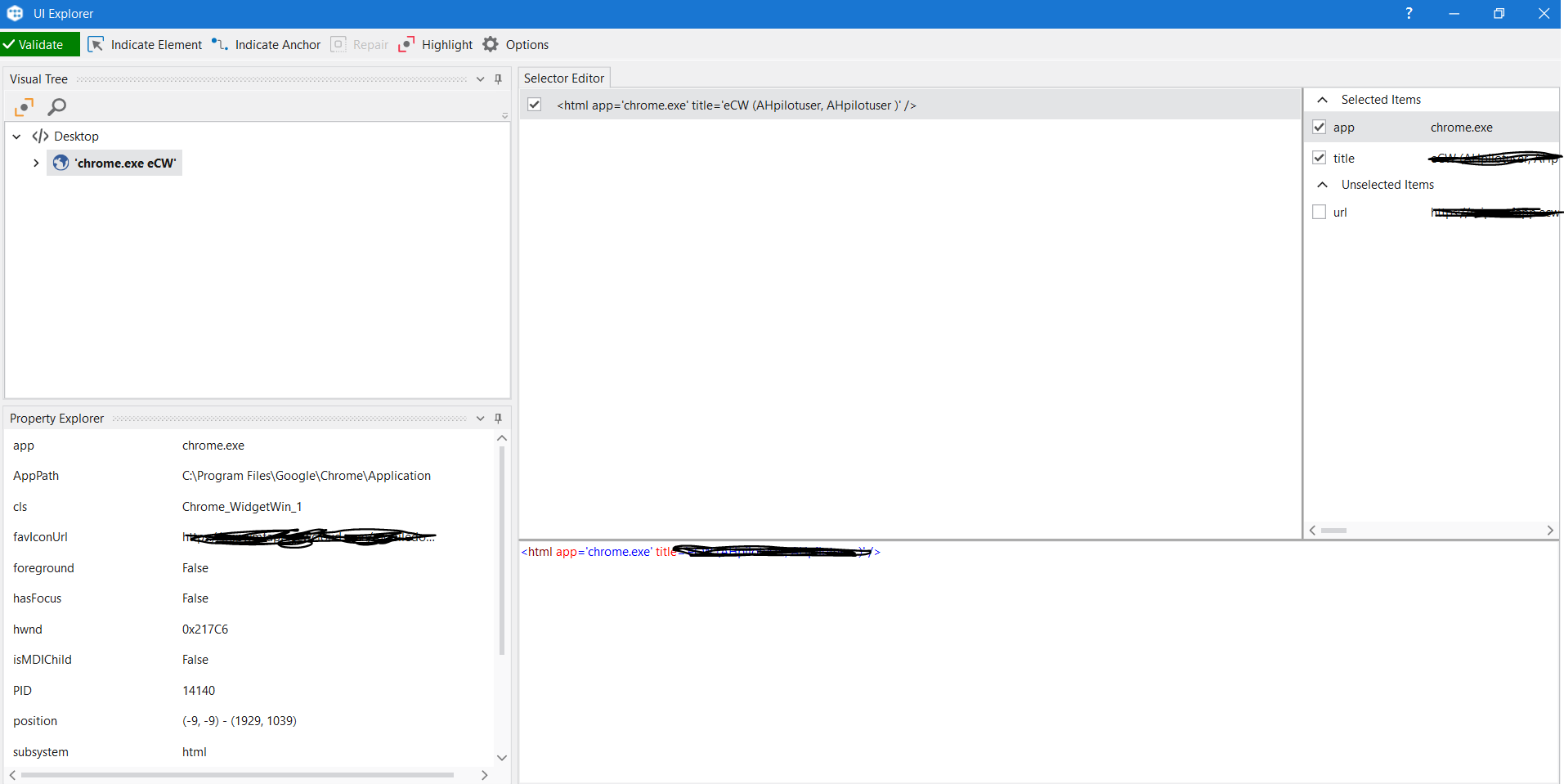

DO you see any id or name or in the ui tree in your ui explorer check the parent elements if it contains a table name. use those properties. If you are not able to find paste the screenshot here we can try checking.

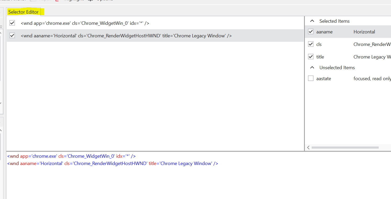

Try selecting different line here and see the corresponding properties in Selected Items
Did you install chrome extesniom and are any items getting spied?
Because i dont see anything other than main window…either you did not indicate anything other than window or no elements in that html are spiable but i dont think thats the case if extension is installed
