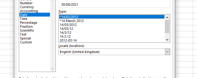

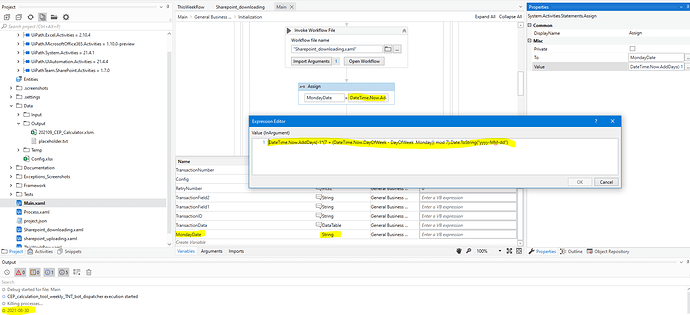

I still have a problem I am able to describe what is a date of this week monday via: “DateTime.Now.AddDays(-1(7 + (DateTime.Now.DayOfWeek - DayOfWeek .Monday)) mod 7).Date.ToString(“yyyy-MM-dd”)*” but via this I am not able to find specific date in excel file where is a date in same format mentioned. I think the problem is in “variable type” I asign this monday like a string but in excel file is system.datetime format. Do you know how to switch from string to datetime?
Conversion from String to DateTime can be done using: Datetime.ParseExact(MondayDate,“yyyy-MM-dd”,System.Globalization.CultureInfo.InvariantCulture)
Also, after extracting the date from the excel file I advice you to trim the value (the variable of type string), as this might be the reason why you don’t find specific date in excel file similar to the Monday’s date.
In the example I have sent you the value from the excel is date format
after I run the project that I have sent you, this is the result:
In the project you can see the excel that I am using.
Check if the format in the excel file is the same as the format of the value that you have when getting the Monday’s date
Okay, try to change the ModayDate format like DateTime.Now.AddDays(-1*(7 + (DateTime.Now.DayOfWeek - DayOfWeek .Monday)) mod 7).Date.ToString(“MM/dd/yyyy”)
