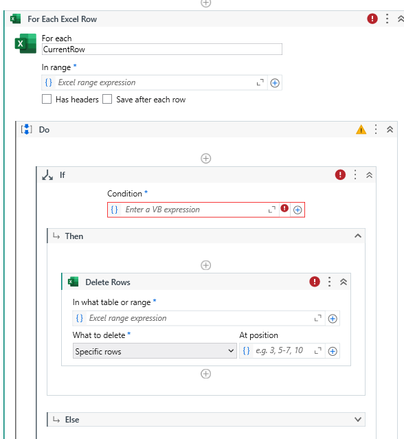

You want to do it with only excel activities, then we have to use For each excel row activity to iterate each row and then use If activity to check the condition and by using delete rows activity we can delete the particular row.
Hope you understand!!
