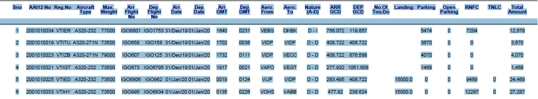

i want to extract data fro PDF to Excel or csv ?
tried splitting string to array and put in data table but fails due to empty space in column.

report.pdf (8.5 KB)
Please find the attached sample report

i have tried both data scrapping and few OCR to extract data but not able achieve desired result as it doesn’t read space and directly jump to next text field.
