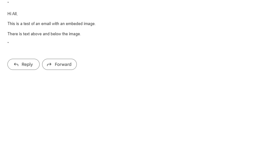

@bcorrea I just tried and still getting it as an attachment. Plz take a look on the snapshot but i need it as an inline image.Untitled
I dont understand what is in this snapshot, but also, note that some mail client, might not support seeing the images in the body…
I attached the above image which has “Uipath Testing” as a body message and test.png as an attachment.

I make sure that
isBodyHTml is checked and though everything is done still the image is getting as an attachment or just showing an image icon in the body.
