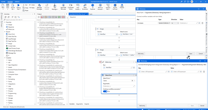

I have my Htmltext as variable which consists of table data and the field key in the form
I have created dictionary variable as suggested and then what to pass and how to pass

Now use an Assign activity before the Show Form and pass this
formData = New Dictionary(Of String, Object) From { {"HtmlTable", Htmltext} }
Here HtmlTable must match the Field Key you set in the form’s HTML Element and Htmltext is your variable containing the HTML table string also formData is your dictionary variable of type Dictionary<String, Object>. Now in the Show Form activity go to Input Data and pass formData as the value.
inside the form, open the HTML Element properties set Default Value to {{HtmlTable}}.
Hi @bhavesh.choubey ,
I have done the following steps where should I declare in HTML element property
{{HtmlTable}} .

You need to declare {{HtmlTable}} inside the Content field of the HTML Element under the Display tab, but before that, make sure the Field Key of the HTML Element is set to HtmlTable without curly braces.
