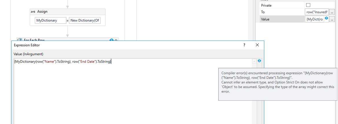

Thanks for the reply.
i am getting this error ,while giving the default value to dictionary.can you please help me.

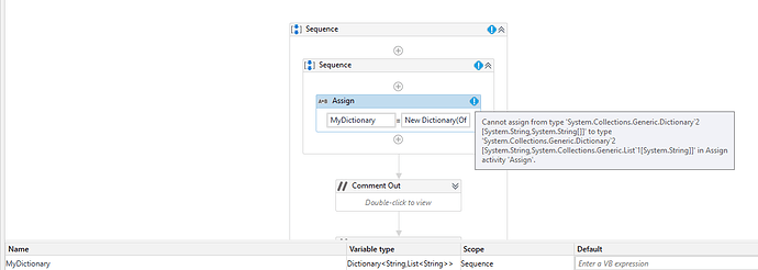

It should be a dictionary with String keys and arrays of Strings, rather than Lists of strings.
yes,list of Strings.
still i am getting this error here.
i didn’t understand,what you are tying to do with this Assign,could you please explain to me once.
