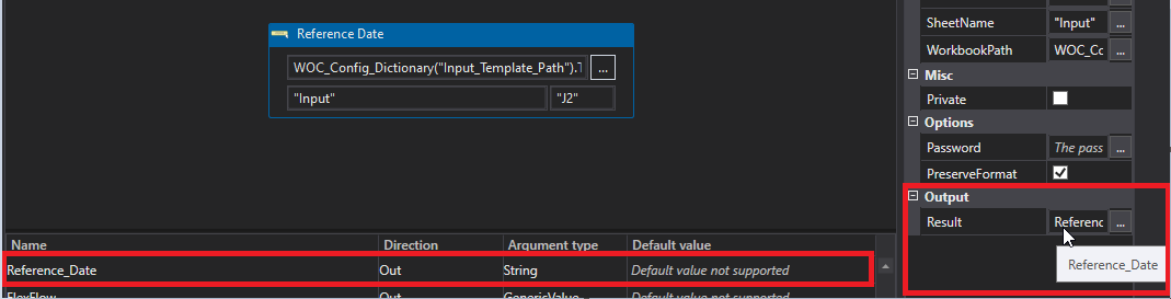

Below is the screen shot where BOT used to read and assign the value.
@nilesh.mahajan I don’t think it’s a good way to directly assign a DateTime type variable for the Read Cell Output. Can you Change the type to String. Then we can Check if the String Data has value and then Convert the Value to a DateTime type.

@nilesh.mahajan Are you able to read the Cell Value using Read Cell and Store it in a String variable? If you are able to do it, Can you show the Value in the Variable using a Message Box?
Only null value I can store into String variable if there is any value in cell that will give error as “String value cannot be converted into DateTime” and If I have change that variable as DateTime then that cell value will correctly stored, but if any null value is there then it give error as “DateTime Converter cannot convert from (null)”
In that cell sometime value will there or some it will be null
String Datatype - String value cannot be converted into DateTime
DateTime Datatype - DateTime Converter cannot convert from (null).
At the time of storing value itself give the error.

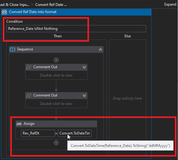

Yes I have solve this challange from my end. I have convert the string into Date format first and then save the same in another variable.
Below screenshot might help you. please try and let me know if any challange.
