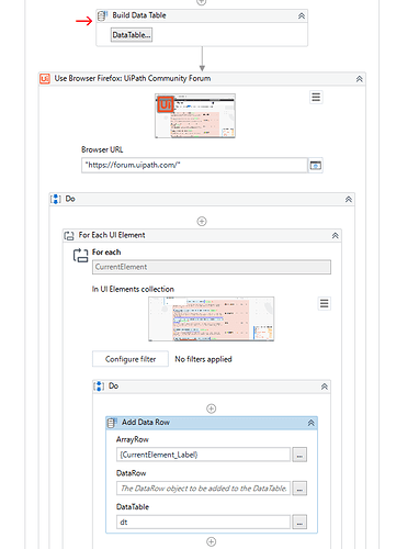

How to convert data variable get from "for each ui element" into datatable for database insertion?
Hi guys, I wanted to get a list of data from a website and store them into database, how to convert data variable get from “for each ui element” into datatable for database insertion?
HI,
There are some ways to achieve it. As one of them, we can use AddDataRow activity as the following, for example.
Hi Yoichi, what if I have multiple element? How can I store them into datatable?
Have this error as well
I guess we can use auto-generated variable such as Address or similar name variable for example.Then we can set it as {Address, BuildingType, ...} at ArrayRow in AddDataRow.
For now, can you check if you can use the above variable in ForEachUIElement activity?
I will have this error, If set in { }
For now, can you check type of these variable?
OR
Can you try to add .ToString like {SpaDate.ToString,Address.ToString}, then check its content ?
Alright thanks
Will have error at runtime, may I know what’s the issue?
HI,
Did you create DTAdd in advance? It’s also necessary to define column.
Yes I defined DTAdd as arguement already, for column is it correct I defined like this?
I still have the same error after doing these, what should I put for the DataRow?
Can you share screenshot of Locals panel when error occurs?
Here’s the screenshoot thank you
I’d like to check Locals panel.
Ops Sorry I didnt know this is the corret Locals panel.
This shows DTAdd is null. Can you check if DTAdd is set as output of BuildDataTable?
Thanks Yoichi, sorry I didn’t know I have to add DTAdd to the BuildDataTable.
