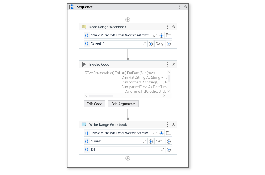

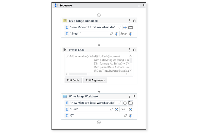

Hi @sruthesanju
Try this
DT.AsEnumerable().ToList().ForEach(Sub(row)
                                       Dim dateString As String = row("Date").ToString()
                                       Dim formats As String() = {"MM/dd/yyyy h:mm:ss tt", "MM/dd/yyyy hh:mm:ss tt","MM/dd/yyyy h:mmtt", "MM/dd/yyyy", "MM/dd/yyyy."}
                                       Dim parsedDate As DateTime
                                       If DateTime.TryParseExact(dateString, formats, CultureInfo.InvariantCulture, DateTimeStyles.None, parsedDate) Then
                                           row("Date") = parsedDate.ToString("MM/dd/yyyy")
                                       End If
                                   End Sub)
Getting error as string was not recognised as valid datetime
Getting the same format as in original datatable not like this Mm/dd/yyyy
