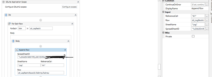

My wish is: to send each row of my datatable to a googlesheet file.
with this method my row is displayed in my file in question {system.data.datarow}
Thanks in advance

@Robot59
with your additional information have a look here:
the hover indicates that the datatype is of Object Array
give a try on using row.ItemArray in this field
Thank you @ppr It works Well
