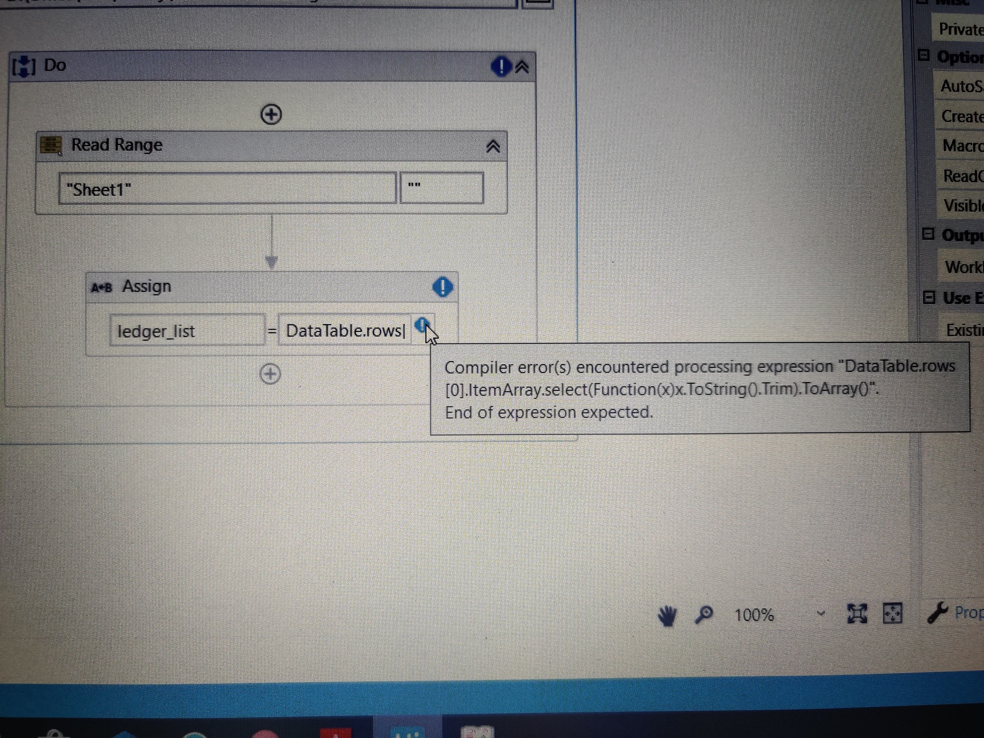

I have done the same but i get this error. Ledger_list is the name of my string array.
@risheviswanath_s
there was a copy and paste typo. try this:
dataTable.Rows(0).ItemArray.Select(Function (x) x.ToString().Trim).ToArray()
