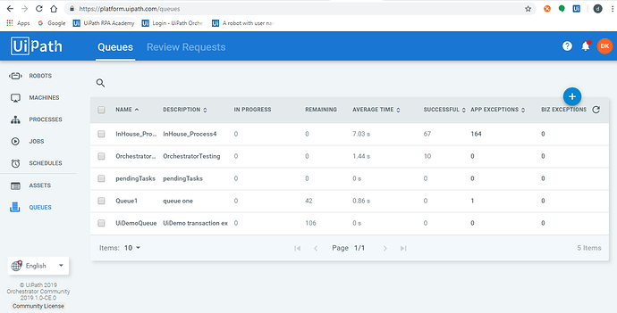

Here the screenshots of exists queue name pendingTasks in orchestrator.js file and uipath orchestrator. do i need to update queue name in anywhere else?
Thanks

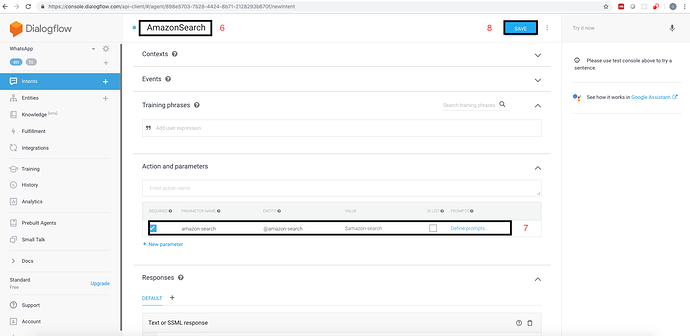

Hi @dilini2004,
That’s all, queue name is updated.
Can you check entity name of dialogflow with that of entity name in lib/Chat.js file.
if entity name is not matching, please update the same.
Thanks,
naveen

Hi @dilini2004,@nalaka_sajith
Please follow the below steps for dialogflow integration
Hope this helps!!
