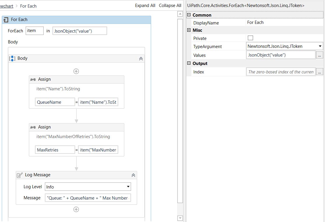

I think one more possibility is to get the max queue retry via Orchestrator API. The endpoint
/odata/QueueDefinitions should give back the necessary information directly from orchestrator queue.
