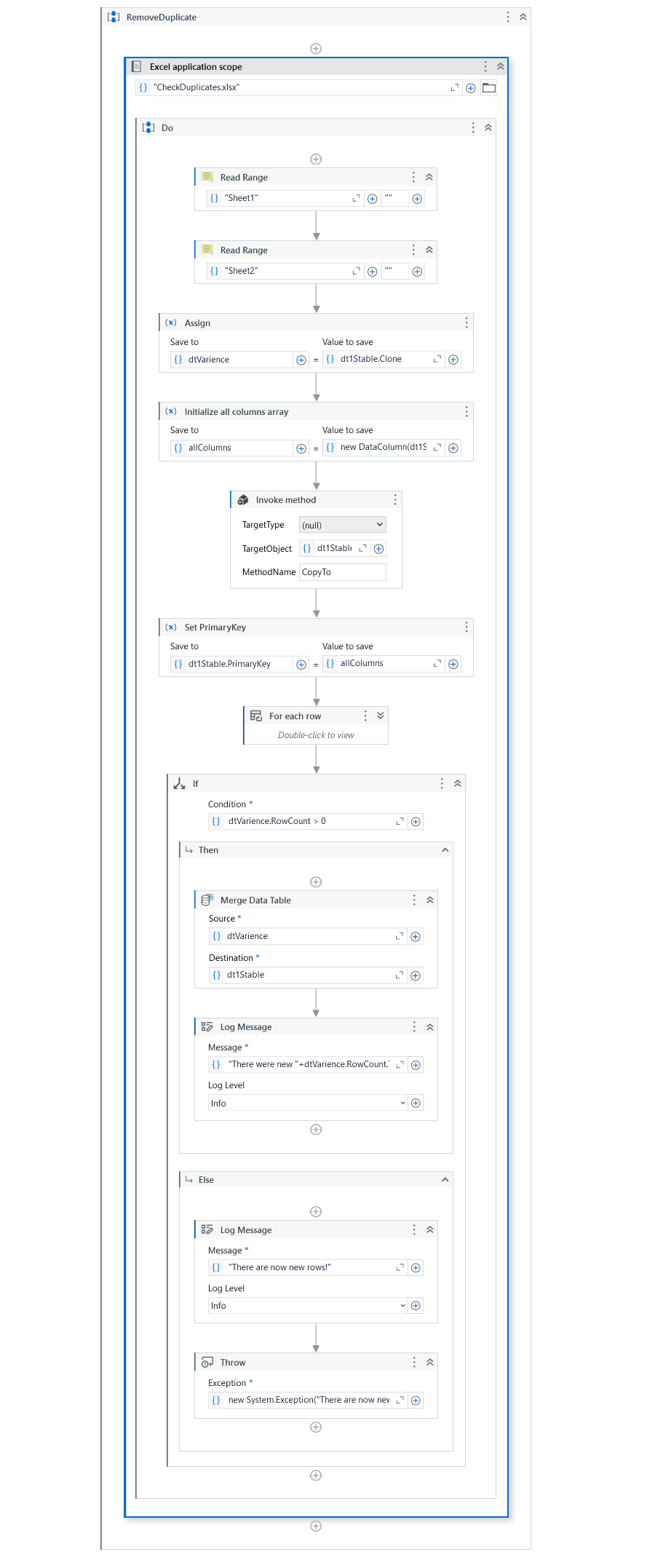

@copy_writes ,
Please check this workflow.
CheckDuplicates.xaml (17.6 KB)

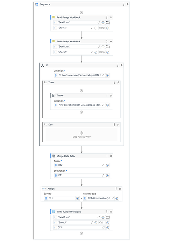

Pleas send it in Zip File
Here you go.
CompareDataTable.zip (10.9 KB)

Thanks For your quick response when I try to open the project I am getting document invalid error
I am using UiPath Studio 2020.10.2 v
Can you please help me.

@copy_writes ,
It was throwing error due to Studio and package difference I guess.
I have downgraded the packages to lowest version available in Studio 2023.10.3
If still the whole solution don’t works, copy only the CheckDuplicate.xaml to your project and this should work as there is no dependency on other things.
CompareDataTable.zip (10.0 KB)
