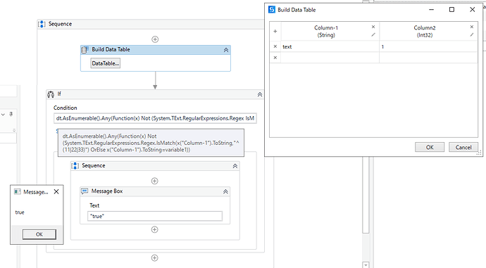

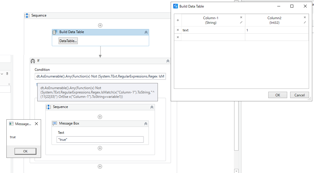

Can you try the following expression?
dt.AsEnumerable().Any(Function(x) Not (System.TExt.RegularExpressions.Regex.IsMatch(x("Column-1").ToString,"^(11|22|33)") OrElse x("Column-1").ToString=variable1))

Does the expression you provided return a TRUE if there is just one row which does not start with 11, 22, etc.?
Yes, as the following.
