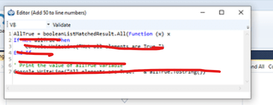

I don’t have Immediate Panel, as i’m using OpenRPA tool.
I’m sharing the code that i have written in the Code editor.
adapt it carefully and also close the bracket
still you can read the shared training and prototype it e.g. with other editors standalone
Yes, i added that bracket there but still not working.

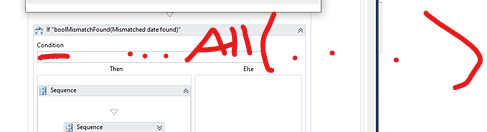

as you can see in our demo it is working. so do the analysis at your end and investigate
  • the correct datatype of booleanListMatchedResult
  • the items of the populated list
  • remove the logs etc
    grafik

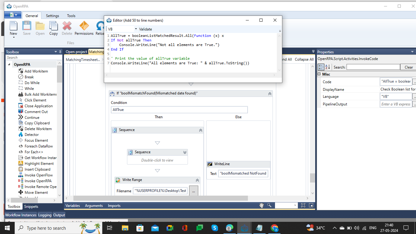

And place it directly
grafik
