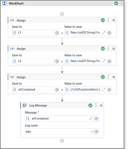

Use this LINQ
allContained = L1.All(Function(item) L2.Contains(item))
Here, allContained
is a Boolean
variable that will be True
if all elements in L1
are present in L2
and False
otherwise.

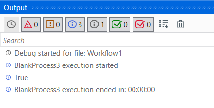

Input:
L1 = New List(Of String) From {"A", "B", "C", "D"}
L2 = New List(Of String) From {"A", "B", "C", "D", "E", "F"}
Logic:
Output:
Sample Workflow:
Workflow1.xaml (7.5 KB)
