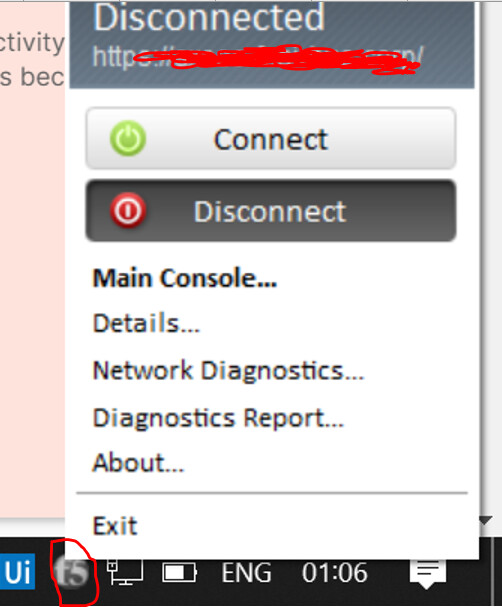

Can you please let me know is there any activity or any process to follow in Uipath where BOT can check whether the BIG-IP Edge client application is connected or not?

Hi There,
You can use Get Process Activity to get all the process currently running.
Put condition after that to check if the list contains your required application name i.e. in your case you can check process name for BigIP edge application.
Hello shubham,
Thank you for your reply and it works
