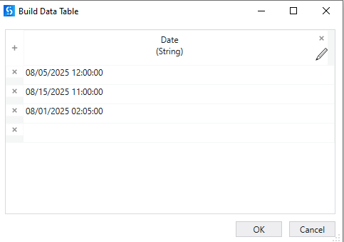

@sharad.bailkar Please look at below images
  1. my data Table
Date Format : MM/dd/yyyy hh:mm:ss
2.My LINQ
(From row In dt_Input
Let a=DateTime.ParseExact(row(“Date”).ToString,“MM/dd/yyyy hh:mm:ss”,System.Globalization.CultureInfo.InvariantCulture)
Select dt_Input.Clone.Rows.Add(a.ToString(“dd/MM/yyyy”))
).copytodatatable
Date Format : dd/MM/yyyy
  1. My Output
Rajesh Rane
