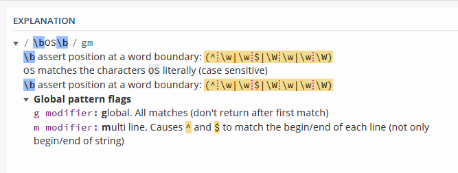

if have only OS (separate OS not in middle of any text)
Regex $ means end of line
but this come in middle also like "14KW 1/3CTW OS RD DIA WB TOSET ”
thank you dear its work thank you so much
For closing the topic, here the explanation on \b from regex101.com
