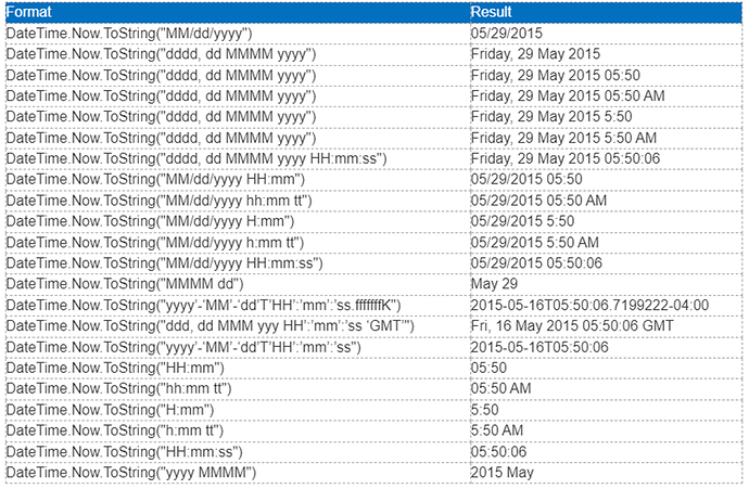

See here for the full list of Date Time formats and examples:
