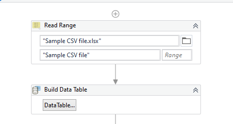

Hi @PALKUMARI_PATEL,
for writing it to a csv file first create a datatable named output_dt using build datatable activity then add data row amount to it and at last write that output datatable to a csv file using write csv file activity. Eg:-
I am uploading the file also.
Main (1).xaml (9.2 KB)
Thanks & Regards,
Shubham Dutta
Hi @Shubham_Dutta Thanks for sample file. Can you explain what you used here ?
I have attached the screenshots of the process also for your reference, you can see after build data table there is that for each activity.
Please go through the screenshots if you are not able to access few activities in my process or else upgrade your uipath.system.activities package to 22.4.4 version after that you can see all the activities in my process.

I did that already but what you assigned in Amount ? Unable to get that part.
Alos Are you using For Each row or For each ?
Amount=System.text.RegularExpressions.Regex.Replace(row.Item(“SALES $”).ToString, “[,]+”,“”)
For each row in datatable I am using.
Thanks & Regards,
Shubham Dutta
