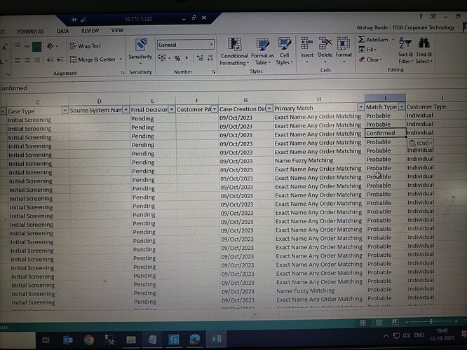

Hello,
In below image there is the column name (Match Type) in that column i have to remove the Confirmed where it’s available in the column remove whole row only I need to keep probable match
Thanks
