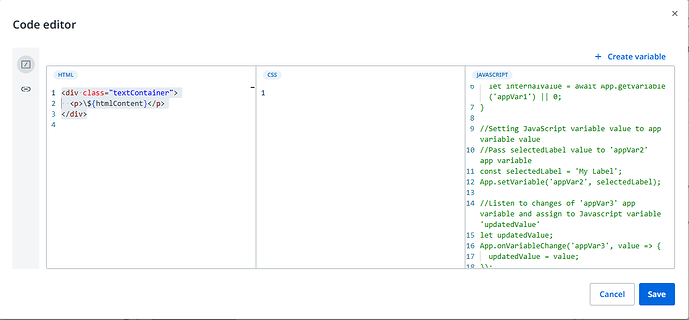

I have a variable htmlContent which is coming from my Process and i have assigned to a variable in UiPath apps, now i want to pass this value in the Custom Html how do I it.
Or is there any way in displaying htmlcontent in UiPath apps where the value is coming from the process
Please Help!

What i am doing wrong here
async function loadEmailData() {
let internalValue = await App.getVariable('jsonData');
console.log(internalValue);
let emailData = JSON.parse(internalValue);

//i am not able to get the value to internal value, in console it says undifined
well you are not using on variable change…so the function would not be triggered
