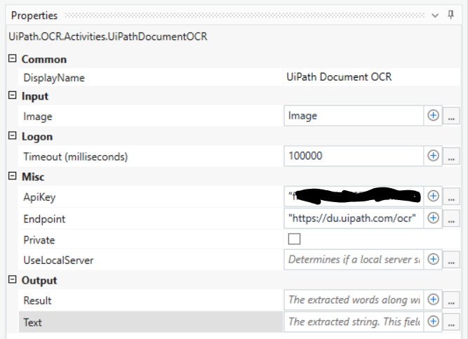

Do you want extract text from image in pdf?
Why you don’t try use ‘read pdf from OCR’ activity?
To OCR engine you can provide your Document Understanding API key and url to DU ocr:

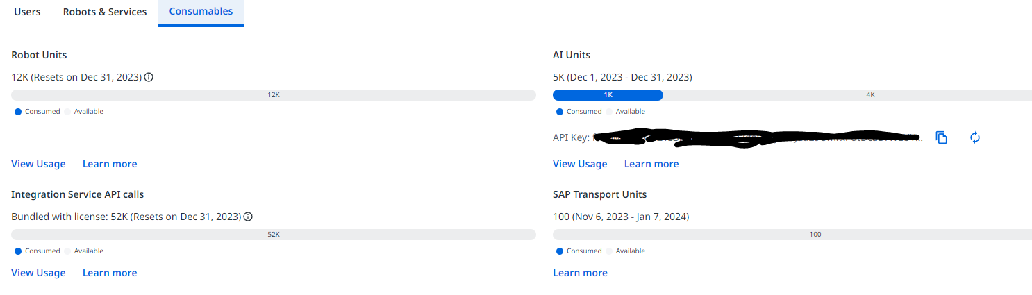

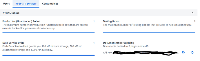

If you have community - API key you will find here:
If you have enterprise - you will find it here:
