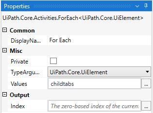

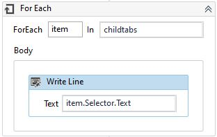

Step3: Drag and Drop For each and Write Line activity from activities panel to designer panel as shown below:
TypeArgument -As the output from find children activity is IEnumerable of UiElement the type argument should be UiElement as shown above.

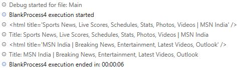

  • Result – This will provide the title of the tab in the IE.
The output after this final step is shown below:

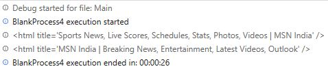

I can not get this to work, “for each” displays nothing
@Zoran1983
That means the items you are passing to for each are empty
Please check the same
I know… wondering why though
