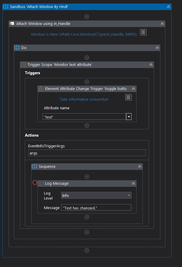

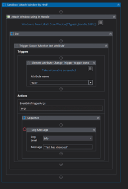

Here are the Attach Window properties
Notice that only the Window property is needed:
After the Attach Window activity successfully executes, other activities based in Selectors in the Attached Window, can occur. In my case, I monitor for updates: Here is my sample sandbox workflow:
