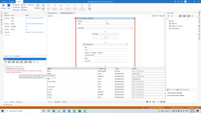

I’m trying to delete duplicate column in Product and other blank data in Price column and repeat the process but it seems that datable needs to modify constantly but uipath wouldn’t let me is there any other way
DeleteBlankdata.zip (111.2 KB)
