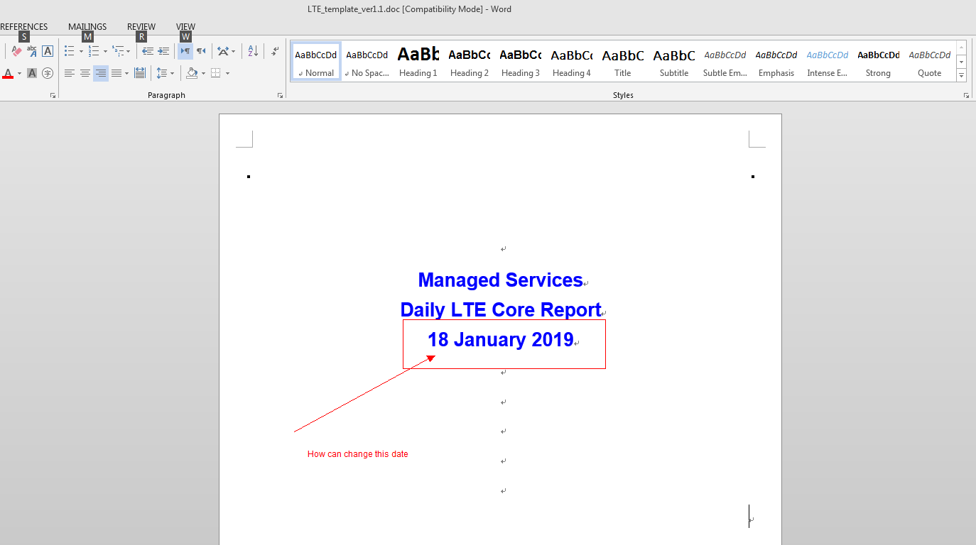

dear All
How can change date inside Word and save this as PDF with this format
i try to use Type into but he type inside the word but not in the same place i want to change in the same place

You can use the word replace text to replace the date in the word document.
or by using send Hot Keys activity to get the replace text dialog window.
https://activities.uipath.com/docs/word-replace-text
Once the text is replaced, use the following activity to save word as PDF.
https://activities.uipath.com/docs/word-export-to-pdf

Example how to get the date in string format -
DateTime.Now.AddDays(-2).ToString("dd MM yyyy")

but how i can Writes date with this format
(06 February 2019)

For 06 February 2019 → DateTime.Now.AddDays(-2).ToString("dd MMMM yyyy")
