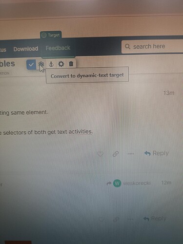

The dynamic text target button doesn’t show up on the program that I want it to use… does work on calculator though.
Maybe there’s a setting?

Hey @weskorecki ,
1.Try selecting ‘Strict Selectors’ for the target after using ‘Get text’ , also ensure the target is dynamic and uncheck ‘Computer Vision’.
  1. You can try using ‘Get OCR text’ activity as well
@weskorecki
From the screenshot we can see you are using computer vision as target method instad find a strict selector and use the strict selector target method
Please indicate the elment in ui explorer and show the selector ot yourself can find a reliable selector…by using center top and right top panels in it…
When I say reiable …it should not contain any number or dynamic data
Hope this helps
@Anil_G It does help, I got the dynamic text target to show up but not on the target that I want. I think I can work around this with some customizations of the target program.
