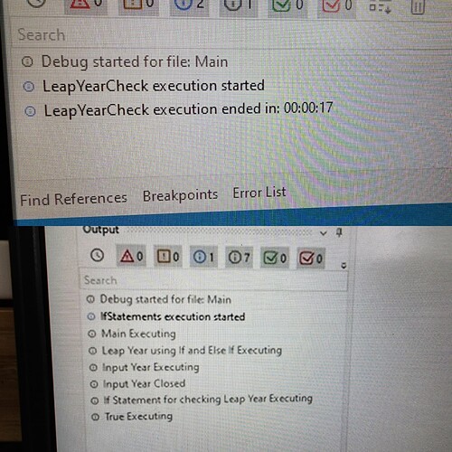

Hi, I am new to Uipath. Am trying out the tutorials and the information in my output window doesn’t seem to be as detailed as the tutorial video shown.
My output window does not show logging of processes or sequences.
My output window (top)
Tutorial output window (bottom)
Is there a setting that I must change? Do help!
Can you try to turn on LogActivities in Debug tab - Ribbon menu, then run Debug?
Thank you! That solved my problem!
