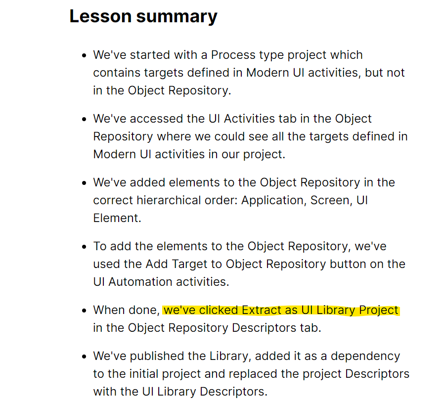

Have a question on object repository but pretty confused how they figured this
for the above question i went through the summary of this and found some statements,please define which part my understanding gone wrong.

hi @Parvathy ,
but in summary you can see after adding elements we need to extract that as UI library project ,so we can use in other projects.
This is wrong. If you click publish from a PROCESS type project you are publishing a process, not a library.
Correct, that’s why the answer is “Click Extract as UI Library Project and Publish the Library”
