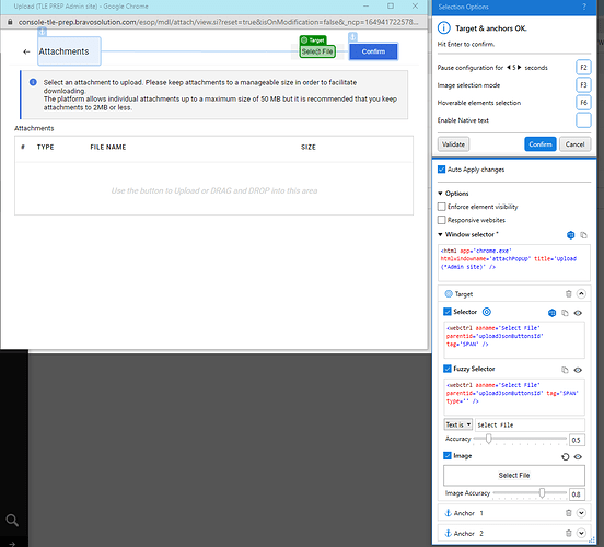

I’m designing a process to upload a file into Chrome.
I’m using Studio.
My site open a popop to select and upload the file.
I designed the process setting all the selector but when the process run cannot identify the popup windows and click the button to select the file.
Below the screenshot.

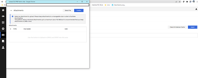

But the issue seems not on the element to be clicked but on the windows where it search the element. When bot run the windows with the button is minimized, and the bot seems looking at the main window.
About Attach Window activity, I do not find since I’m using Modern Design. I can switch to classic, I just would like to understand which one is suggested to be used.
From documentation is seems modern design is better, but is that true?
Thanks for any help.

Approach 1: Remove parent id from your selector and see the results, also make the title as wild card after upload. If possible disable fuzzy selector, image
title = 'Upload*'

Approach 3: Use Activate activity since you are saying that window getting minimized during bot run. This activity helps to get the window foreground

If you’re using Modern Activities, keep only the Target Selector enabled and disable the other Targets.
This maybe the case due to the Selection of the Certain Properties in the Properties Panel of the Use Browser Activity.
If you could provide us the Screenshots of the Activitie and the Properties used, we may be able to change and get the Activity to Identify the Right Window.
