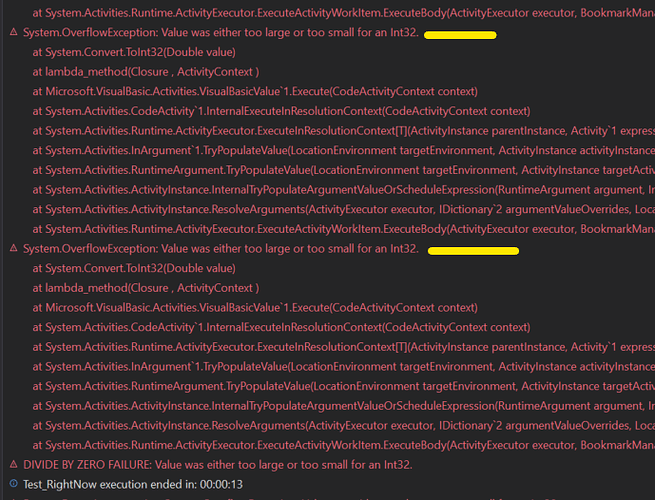

Sorry @naveenkumarr , I should have done this in the first place. Here is something I just put into studio with Global Exception Handler on a current test project I am working on.
You see my main flow has 3 sequences.
- The first sequence works without errors.
- The second sequence has all activities commented out
- The third sequence is a sub-flow that deliberately fails by creating a Divide by Zero exception
You can see that the Global handler catches the error created by sub-flow 3
I have set my Global handler to retry 2 times, and that is why you can see the error twice.
thanks andy ![]()
