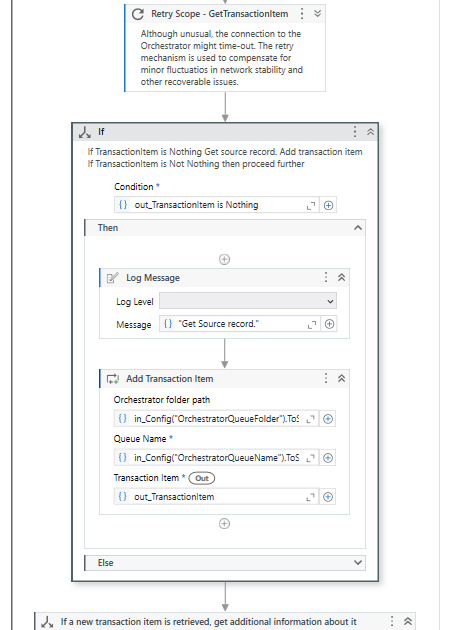

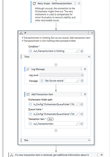

@leobot.dafinci Hi. RE framework have the GetTransactionItem within Retry scope. If no item in queue, out_TransactionItem is Nothing. Add an If condition as shown in image, then place the logic to get the data and add new transaction item. Hope this helps
Thanks Devi,
If I understand it correctly.
Place an If activity after the Retry Get transactionitem (delete rethrow from catch section)
The If activity will check whether there are transaction or not.
If there’s no transaction item I have to put my load queue item sequence into the then section with its own try catch
But I still have to put another Retry Get transtransaction (with rethrow in catch section) after that
Right?

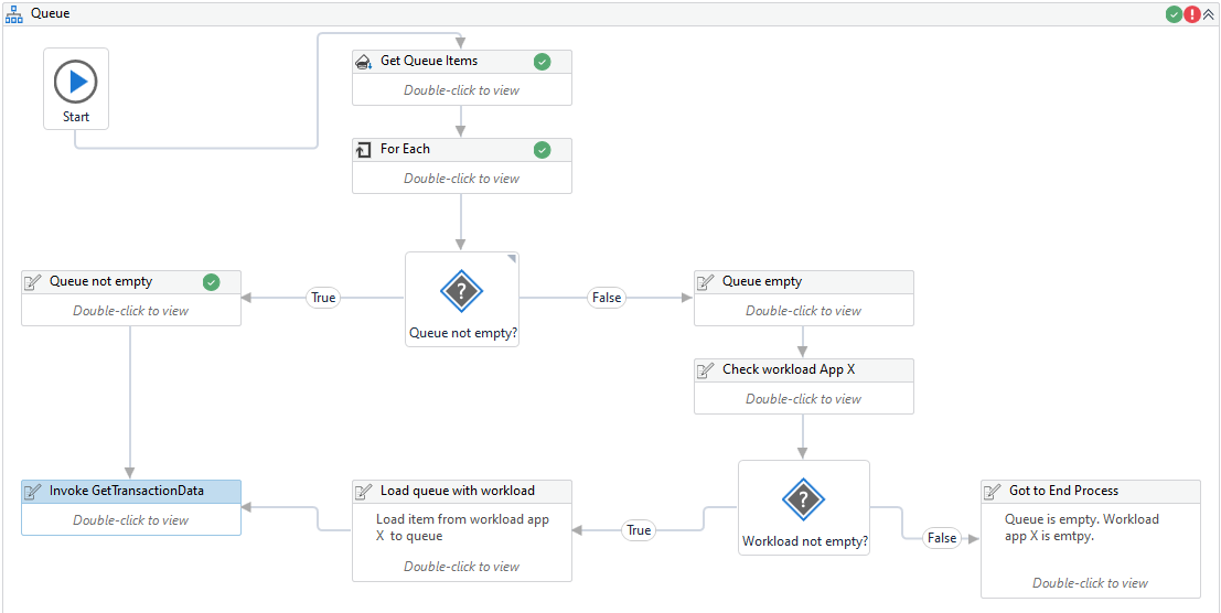

You mean something like this:
Richard
@leobot.dafinci
Yea this is what i was mentioning …but not sure what you are using the for loop . After get queue items…if you are using it to count actually you can do queueitems.count …here queueitems being the output of get queue items
And actually when wueue is empty you wanted to add queue item i guess…but I dont see that may be you can check if that is missing or is it fine
Hey Anil,
I did used an for each to count the queue items. Yes indeed a queueitems.count is much better ;).
An add queue item when queue is empty is not missing. It’s inside the Load queue with workload (I know it’s a log message. This should be an sequence ;)) I had to build a flowchart quickly.
