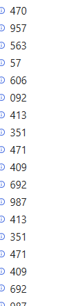

assuming txt = "GRAND TOTAL (I + II + III);470,957,563;57,606,092;413,351,471;409,692,987;GRAND TOTAL (I + II + III + IV + V);413,351,471;409,692,987"
  1. assign system.Text.RegularExpressions.Regex.Matches(txt, "([\d]+)") to regexCollection variable
  2. loop regexCollection variable
result
