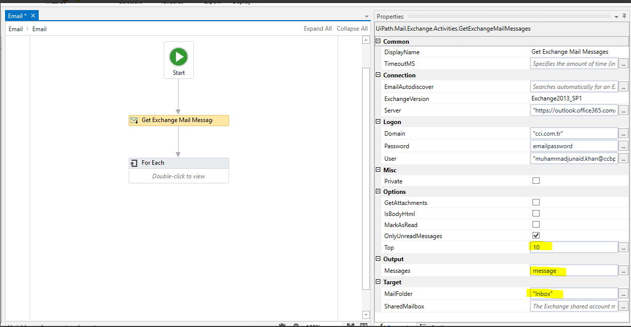

i have some small issue in my program, need your expert comment/Support on that, i am going to take decision after fetching the email through exchange mail with specific subject,

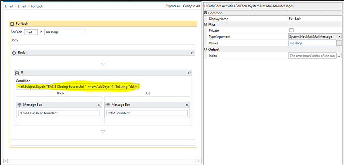

I WANT if subject will found then he send me message box with “founded” if not then message “not found”
Let take example if we have 2 unread email, Program will fetching the first unread mail which does no have same subject what i need he send me meesga “NOT Found” then after fetching the 2nd email where he found the subject he runs that, but i want that why it run on first time when he did not found the subject, here is the screen shot
i just needs that he just check the all unread email if specific subject exist then he send me message instead of send me two message, first not found then found
