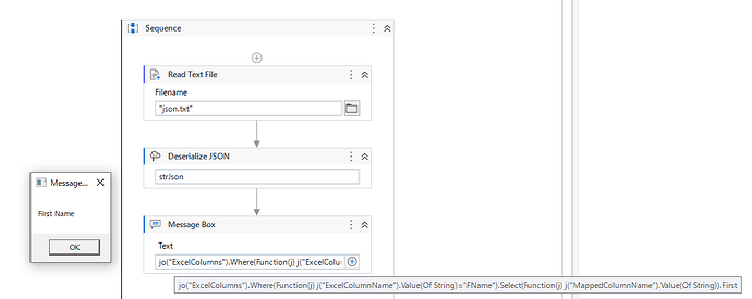

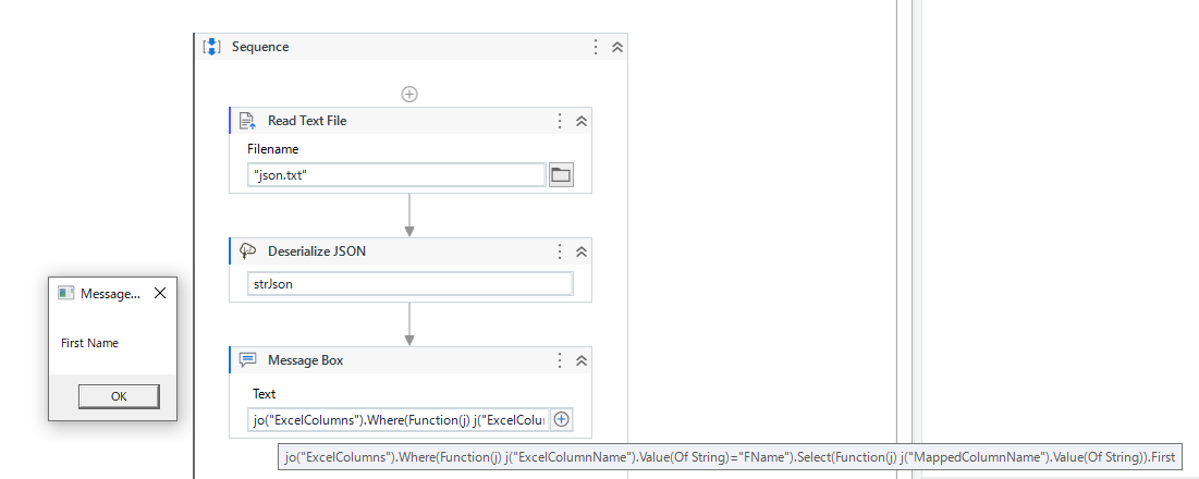

Hope the following sample helps you.
jo("ExcelColumns").Where(Function(j) j("ExcelColumnName").Value(Of String)="FName").Select(Function(j) j("MappedColumnName").Value(Of String)).First
Sample20230119-1L.zip (2.6 KB)

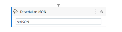

grafik
output: myJObject
