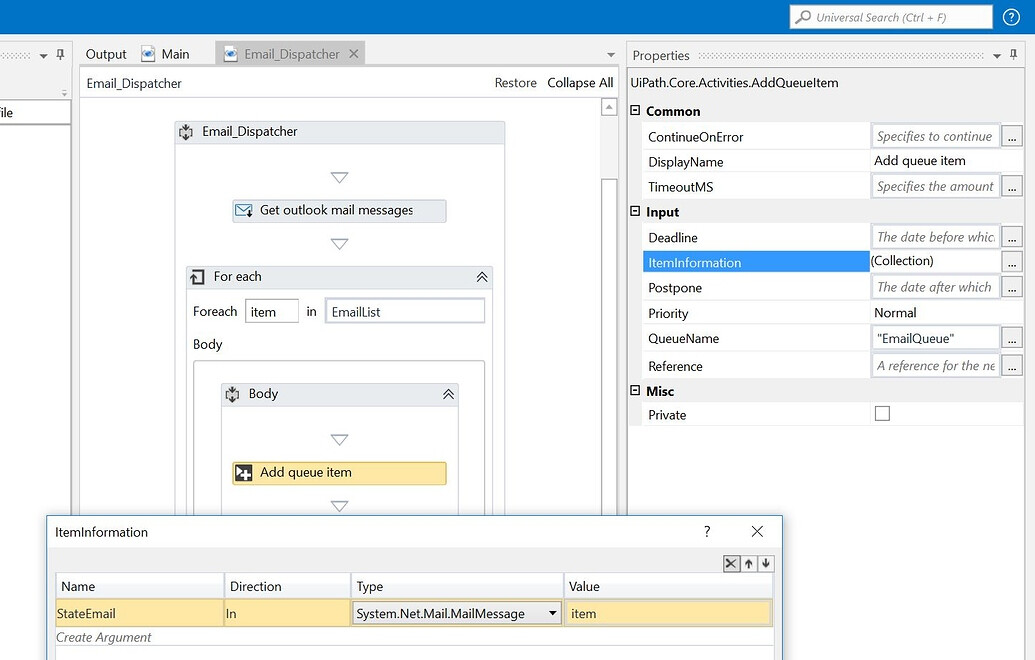

I can add Mail Message into Queue item as below, using Add Queue item collection I can able to add it. Maybe it is helpful for you.

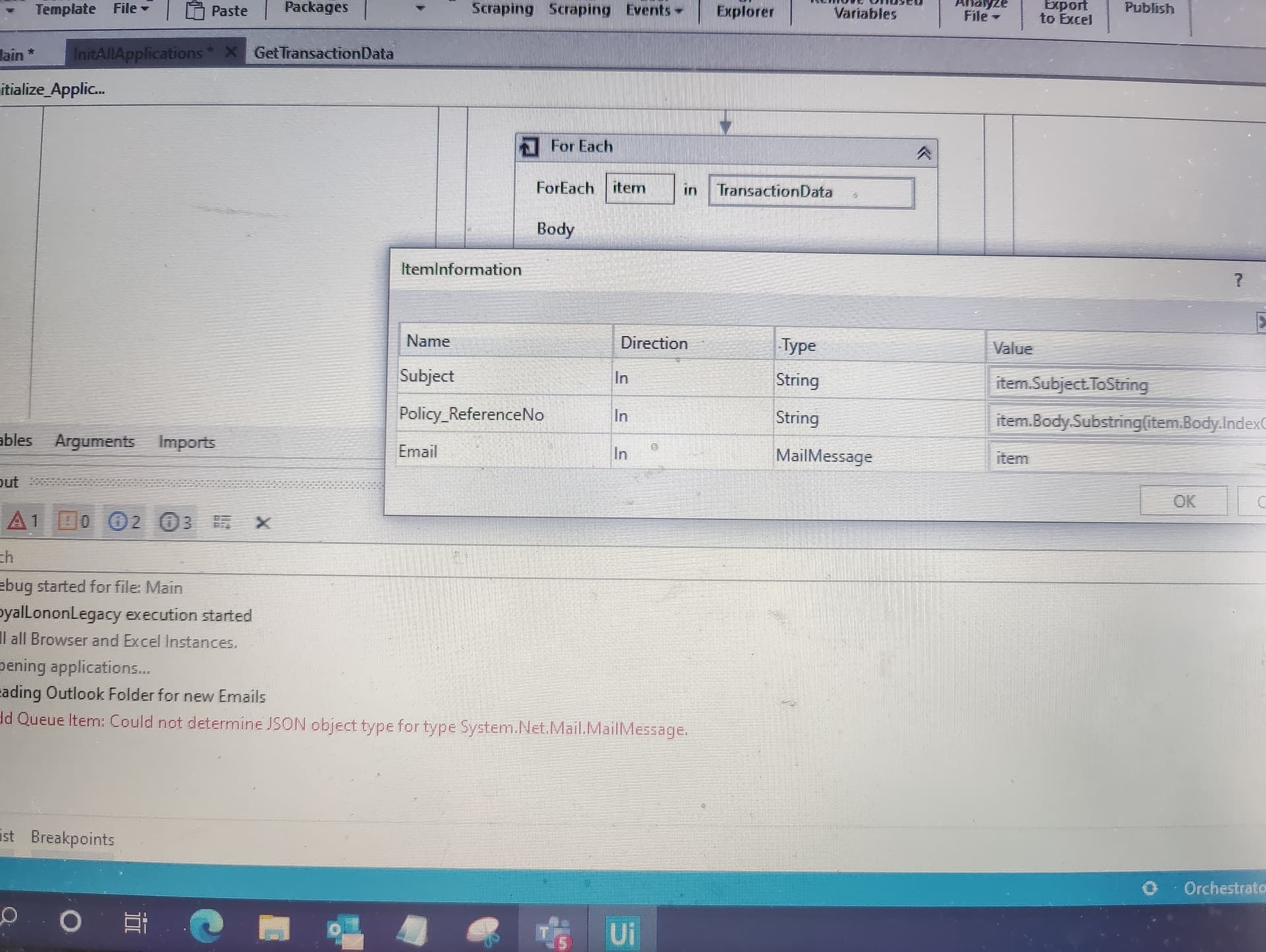

When try to add mail message to queue it is throwing error as " could not determine JSON object type for type system.netmail.mailmessage
Hi @Priyanga_Karnan ,
I also tried, you cannot pass the entire mail message to queue in UiPath because it is not serializable but yes you can pass the mail body, subject and other information as a string.
