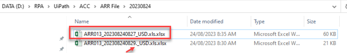

Software export 2 file:
ARR013_yyyyMMddhhmm_USD.xlsx.xlsx (want get)
ARR013_yyyyMMddhhmm(.)_USD.xlsx.xlsx (no)
I assigned it as below but not correct. How can I get the correct file?
Directory.GetFiles(“D:\RPA\UiPath\ACC\ARR File"+DateTime.Now.ToString(“yyyyMMdd”)+”",“ARR013_*_USD.xls.xlsx”)

Directory.GetFiles("D:\RPA\UiPath\ACC\ARR File\" + DateTime.Now.ToString("yyyyMMdd"), "ARR013_*_USD.xlsx.xlsx")
This should match files with names like “ARR013_yyyyMMddhhmm_USD.xlsx.xlsx” as you mentioned you want, and exclude files with “ARR013_yyyyMMddhhmm(.)_USD.xlsx.xlsx” as you mentioned you don’t want. Just make sure you replace “yyyyMMdd” with the actual values you need to match the desired timestamp format.

Directory.GetFiles("D:\RPA\UiPath\ACC\ARR File\" + DateTime.Now.ToString("yyyyMMdd"), "ARR013_*_USD.xls.xlsx")
Regards
May be use RegularExpression
Directory.GetFiles("D:\RPA\UiPath\ACC\ARR File" + DateTime.Now.ToString(“yyyyMMdd”))
System.Text.RegularExpressions.Regex.IsMatch(currentItem,“ARR013_[0-9]{12}_USD.xls.xlsx”)
