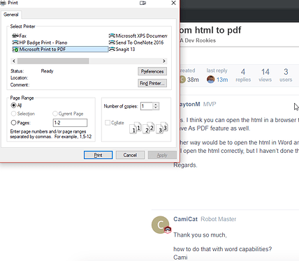

Thank you so much,
how to do that with word capabilities?

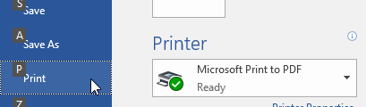

You can use Save As or Print. I think Print to PDF works well.
You can get there with alt+f+p
TypeInto "[k(alt)]fp"
The only problem is Word might not format your html correctly, but you can try it.
I think opening it in a browser would work better. You can use Open Application or Start Process to open Chrome or iexplore with the html filename as the argument. Then, use the Print
You can get to Print by doing ctrl+shift+P
Then, Select Item for the Print to PDF option
Regards.
